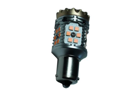

I've just purchased the Twenty20 bulbs below for mine (the link is the exact bulbs you'd need for the MG)
I've used them in about 4 cars now and they're amazing. They produce 1800 lumens per bulb! They also have a special thermal compensation programme, if the bulbs are used for a long time they can get hot. So the bulb automatically reduces the brightness to protect the bulb and wiring from damage.
They're so good they even come with a 3 year warranty. They're completely plug and play and have built in resistors so they don't hyper flash. At £28 a pair they're not cheap but you get what you pay for ??‍♂️

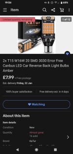

I've just ordered these for the rear of mine
(eBay item number: 124096970464)
I'll let you know when they turn up if they're suitable, they say they don't cause hyper flash due to how powerful they are.

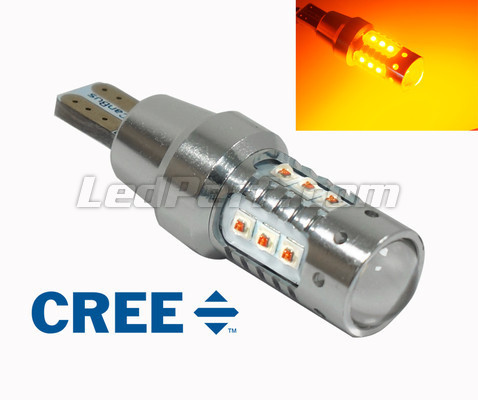

I had already took the plunge after Marcad's link to go with the Cree rear indicator bulbs from here:
LED bulb T15 WY16W with 16 leds CREE orange for turn signals
But have gone with your suggestion of the Twenty20 bulbs for Front Indicators (581) and Side Repeaters (501).
The only thing wrong with the Cree Bulbs is they only come with a 12 months guarantee, which you can extend to 2 years at a cost, but all the Twenty20 bulbs come with a 3 year guarantee automatically, which is much better.

My bulbs arrived today, both the Twenty20 and the cheaper LED bulbs for the rear indicators I listed above.
The rear bulbs work fine and I can confirm they do not hyper flash.

Hi Andy,
Those bulbs you linked look superb and almost as bright as the Twenty20 front bulbs!
If my versions from eBay hadn't have worked I'd have bought the ones you linked.
