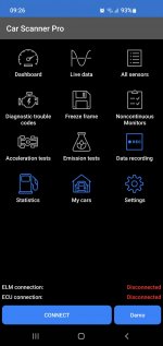

Just wondering if anyone had successfully got the EV profile of this app working on the ZS 2022 facelift car? It connects but doesn't show all the important values like SOC and battery temperature.

Car Scanner Pro, paid the £4 to get it ad free.
Thanks. Ordered it off amazon...mine is probably cheap crap 👍
Yep, me too, but I'm only getting some very patchy data, and lots just plain wrong. And it's the same as my other dongle. I'm going to send this one back. It looks to me as if the Gen2 LR is using non standard setup, I don't know enough about it. I DO get enough for ABRP to work, so that'll do for now. Any help with getting this working would be great.
