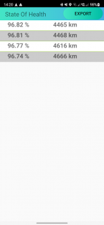

I've got the exact same experience with my SoH of my Mk2 SR, so on first service I will be asking them to check it, I've done similar mileage as you and been charging on ac for 99% of the time for the last 5 months and a half.
So, I've now done a few 100% charges since I last posted, and it seems my SoH of the battery keeps going down slowly, at least from look at the eZS app.
Not concerned yet, but will continue to monitor for the next few months, i'm now tracking this
