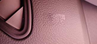

I ask it because i saw this strange spot on my dash☹️ i never touch the dash and ik never saw it before...it looks like a old tape spot in the factory mayby? Have anyone else something like this?

Is it still sticky,...like glue ?
If so. You could try WD 40.
WD40 is a silicone spray and removes all kinds of adhesive backings. But first make sure you have a degreaser at hand that's suitable for car dashboards because WD 40 will leave a shiny greasy residue.
(Before testing out on the real problem area always try out new solutions to a not visible surface.)
By watching your picture I think that the tape was left on there a long time and has been removed with force,....taking away a tiny.part of the top layer of the plastics....
Don't forget a good cleaner for after u use the WD40!
And Don't spray directly on the dashboard!!!! Spray on a microfibre towel outside of the car!!!
