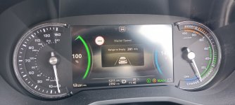

Not necessarily ? 250 miles done with 24% battery left ?
