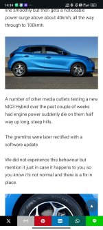

Just saw some articles MG3 Hybrid+ software update. They say that the problem is fixed. I have mine in the workshop after an accident I had. I will request the update after it gets fixed and I will get back to you after testing it.
