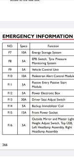

It quite easy to find a permanent live with a cheap volt meter or a bulb test pen when car is powered down on the fuse bord
There is a fuse 13 is for drivers seat can you adjust seat when not powered up? There is a diagnostics line on fuse 2 that could stay live fuse 3 is alarm fuse 11 passive entry

I need to find the correct permanent live for my dash cam,

cheers that’s really helpful I’ll be connecting it tomorrow, but thank you for the info.I have just hardwired a garmin into 2022 zs ev trophy. Really easy. Fusebox is behind glove compartment. Took out glove box. Just two plastic "screws" inside glove box...90degree turn and they pop out. Also remove two screws underneath and cover drops down which gives access to fuse box...I used piggyback fuses and for perm live I used seat adjust fuse 13 and fuse 15 front power socket for ignition live
