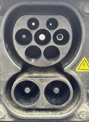

Hi everyone, I would be grateful for your advice.
We just had a service done and I was told that the pin top is missing on one pin in the charging port. Please see picture attached. The MG dealership has not been helpful so I am wondering if anyone else has had this issue and if it is an easy fix. Many thanks!

The charger port is covered by the MG 7 year warranty (according to Google). The tips or pins are user replaceable (if you can source the parts) rather than getting a whole new port. Some Hyundai and other cars have the same issue. I guess it's a commonly bought-in part from a third party manufacturer.
Edit: Stick 'pin top missing on ev charge point' (no quotes) into Google. Video about Ioniq not far down the list

Thank you - their response has been you can't have the tiny plastic cover separately and will need to pay circa £700 for a complete new port and labour on top. They also said they need to do an investigation to see if it falls under warranty or not and if it doesn't then I am liable for all costs.

Thank you for this! I will see if I can source the tiny plastic cover myself. MG dealership have not been helpful. Cheers
There's a new unit here on ebay for £300 > MG5 Charging Port.
See this Reddit discussion from 2 years ago on the Ioniq 5. There is a pic part way down with a part number. I wouldn't mind betting there is a high probability that (the physical) CCS2 charging sockets do not differ between car manufacturers and all come from but a handful of producers. It's absolutely crazy to change the whole unit for a plastic cap or two!
