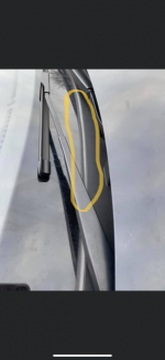

I had this very same issue since having the car for more than 2 years. So I posted the issue on FB and had some amazing response and the issue can be fixed with a good spray of WD-40 along the scuttle plate on the outside of the windscreen.
That’s the place !.
Also, right in the corners of both front wings, where the scuttle seal disappears under a rubber gasket on both sides.
Where the curve of front windscreen glass meets the rubber gasket in both corners.
