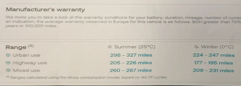

Similar experience with my Long Range ZS. After a charge to 100% the GOM said only 247 miles range instead of 273. The next dayafter an 80% charge the GOM said only 198 miles which, pro rata is the same loss of 10%. I have asked for a battery dtate of health check which the gargae have said they will do but they also said "Please be reassured that variations in the indicated range are quite normal at this time of year, as colder weather typically reduces the displayed mileage due to the additional energy required for battery conditioning and cabin heating. This does not necessarily indicate any loss of battery performance, and those estimations will likely improve again as we get into Spring next year."

Battery State of Health: 100%,
Explains something to me but not your issue.
Have done a reset of acclimated trip? And is it reading 100% of charge and what is the range
I notice that my range has gone up in the milder weather of the last few days
You will see a 30% drop between the summer and winter
I expected a drop in range. What I did not expect was that car would estimate the range reduction. Is it calculating that based on the time of the year or actually using the ambient temperature in its calculation?
