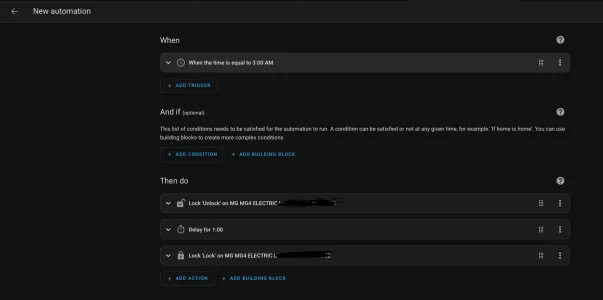

My idea is to do this lock–unlock procedure automatically every day so the car won’t enter this deep sleep state.

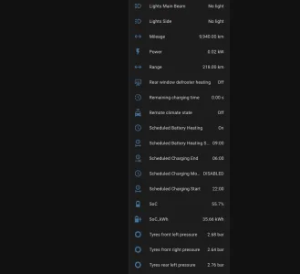

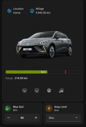

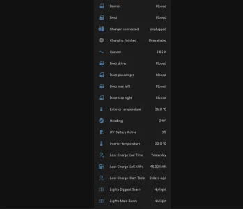

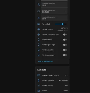

I would do this with either one of these two Home Assistant add-ons (they give you full access to the car and even let you see some things that you can’t see in the MG app). More interestingly, they also give you the option to build your own automations. The possibilities are only limited by the actions that MG provides—so instead of doing this unlock–lock trick, you could also preheat the car, seats, etc. via one these integrations:
I also use Home Assistant, but there’s one problem with this idea. As even the developers pointed out, the lock command sent from HA often doesn’t work because the car responds by saying to check that there are no keys inside and doesn’t lock. So we’d risk leaving the car unlocked.
How does the iSmart app work around that issue? (I'm assuming it's using the same API as its base).
The idea would be that the car will never enter this deep sleep mode again so therefore it will be always available.
Haven't thought about that..

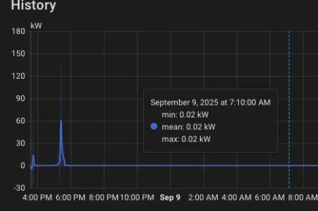

I would say it's actually not that big of an issue. Of course, it will depend on the size of your 12 V battery, but if we assume the battery has 55 Ah, that would be 0.66 kWh (12 V×55)/1000. The measurements from the integration show a consistent baseline power draw of around 20 watts. So, if you don't park your car and leave it unused for weeks, you should be fine.
The massive peak in the screenshot was me driving on the Autobahn🤣
