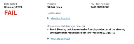

Hi All, the car just failed it first MOT l. It is now with MG Tunbridge Wells to fix. I will of course let you know the outcome

This should be a wake-up call to MG and any owner with the same issue. Any failure of a first MOT is bad news, first I have heard of for a long time.
