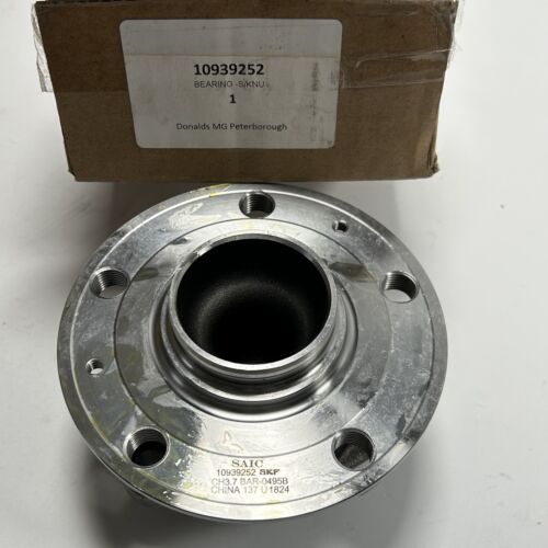

Well, I managed to change the right front bearing. The m12 triple square bolts were incredibly tight so I removed the whole carrier from the strut to get access, the bearing was a bit seized to the aluminium so just as well I think.
Good news though, it has cured the clicking !:) Holding the old bearing in my hand I can feel a sort of 'tapping' from it as it's turned although it doesn't make any noise as such, the new one was smooth to turn by hand as expected.
Levered the rear cover from the bearing to see if anything was obviously broken inside but all that's visible is the magnetic ring for the wheel sensor which looks fine.

Our forum member Submariner visited the service center last month, suspecting that the noise might be coming from the bearing. The service team removed the tire for inspection and confirmed that the noise was indeed coming from the bearing. To test this further, the bearing from the MG4 test vehicle at the service center was installed Submariner's mg4, and the noise was eliminated, confirming the issue. Following this, the replacement part was ordered and is expected to be installed next week. If the noise is resolved, I plan to visit the same service center as well. We will share updates on the outcome.
Hi there,
Sorry for the late feedback, but it took the MG Service Center a terribly long time to get the spare parts available. Finally everything has been solved and I'm driving as quiet as a mouse and in peace... :)
Yes, the noise was definitely from the Hub Assembly just as "Macadoodle" had confirmed at the beginning. So once again I would like to THANK HIM SO MUCH for the feedback he has provided here. If it weren't for his feedback, I think I wouldn't have been able to "convince" the stubborn mechanics at the MG Service Center (and myself to be frank) that the noise was from the hubs. The video below is from the workshop recordings as aforementioned. The typical sound from behind the damn steering wheel...:

@Macadoodle I also need to change my bearing on MG 4 but i can't find part number for the bearing itself. I want to buy parts before disasembly, i only found Skf Bah 0043 Cx but it says its for MG 5 and i don't know if it's compatiable.
