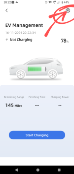

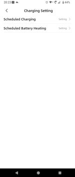

Look up this on the app, it's not there?
