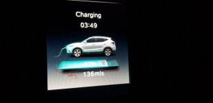

I know this may sound like a really daft question, but I will ask anyway. LOL.
On your first image, your SOC IS 87% with what looks like a healthy predicted range of 136 miles in "Normal" mode ( shown on the second image ).
And the car looks like it is pulling a charge, are you charging from the "Granny" by any chance ?.
I ask, because the image clearly displays that the charge will complete in 3 hours & 49mins.
At just under a SOC of 90% and plugged into a 7.0 kw wall box, the charge should complete in about 1hour 30mins and not 3 hours 50 mins ?.
The figures shown in the image would suggest a charging rate of only 3.6 kw's or even less ?.
I have a genuine reason to understand the answer to this question please.
