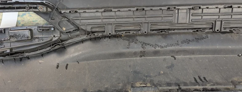

The bumper was split all over the place and basically was a write-off however I thought I'd get a plastic welding kit and see if I could repair it (and the diffuser which still refused to come out).
Total success! I'm amazed. What was a shattered cracked and in many pieces bumper, is now solid and looks pretty good. I need to do a spot of filling and then spray it but even now it looks incredible compared to what it was. I even repaired the diffuser, so it can sit there forever now.
Just waiting for the replacement crash bar and the car is finished.
Very happy😀
Here are midway through pictures. I've completely stitched it together but haven't cut the staples yet so you can see more clearly. I've also put foil tape on the joints so glue won't seep through but it also shows just how broken it was. The shape was also all over the place but the heat gun helped me reshape it and take out some of the big dents and bumps.
It's very solid but all the stitching makes it look a bit of a Frankenbumper!
