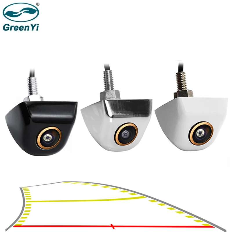

Hi all just thought I’d share the reverse camera installation in my MG4 SE LR. I’ve installed a 170 degree camera with dynamic trajectory parking guidance with a 7.5” replacement rear view mirror 1080p. Not the easiest installation but I think it’s very effective and looks very OEM. Camera is situated in the same place as trophy rear and video cable runs through the rear hatch into the chassis via the rubber cable channels and via the footwells to the A pillar and headlining to rear view mirror. Camera power is via the reverse wire positive and negative in the left rear light cluster using good quality wire taps. Easy to get to through the removable access panel in rear hatch. Also easy to remove light cluster via 2 x 9mm bolts. The rear view mirror has its own bracket that is compatible with the mg4 windscreen. I’ve attached pics and happy to share links to my purchases if you’d like.
