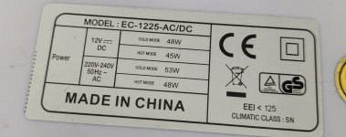

The coolbox is rated at 48w for chilling.
Would I be ok to split the dash 12v and share between the dashcam and the coolbox. As I say, it will only be being used when either driving or charging.

So by my calculations, your fridge should draw 4 Amps (48w / 12v) and I doubt your dashcam pulls much current. A new 12v splitter should solve your problems. Here's one you should be able to pick up locally rated at 10 Amps. THere are others that also have USB sockets if you need them. All the Halfords ones appear to be rated at 10 Amps.
