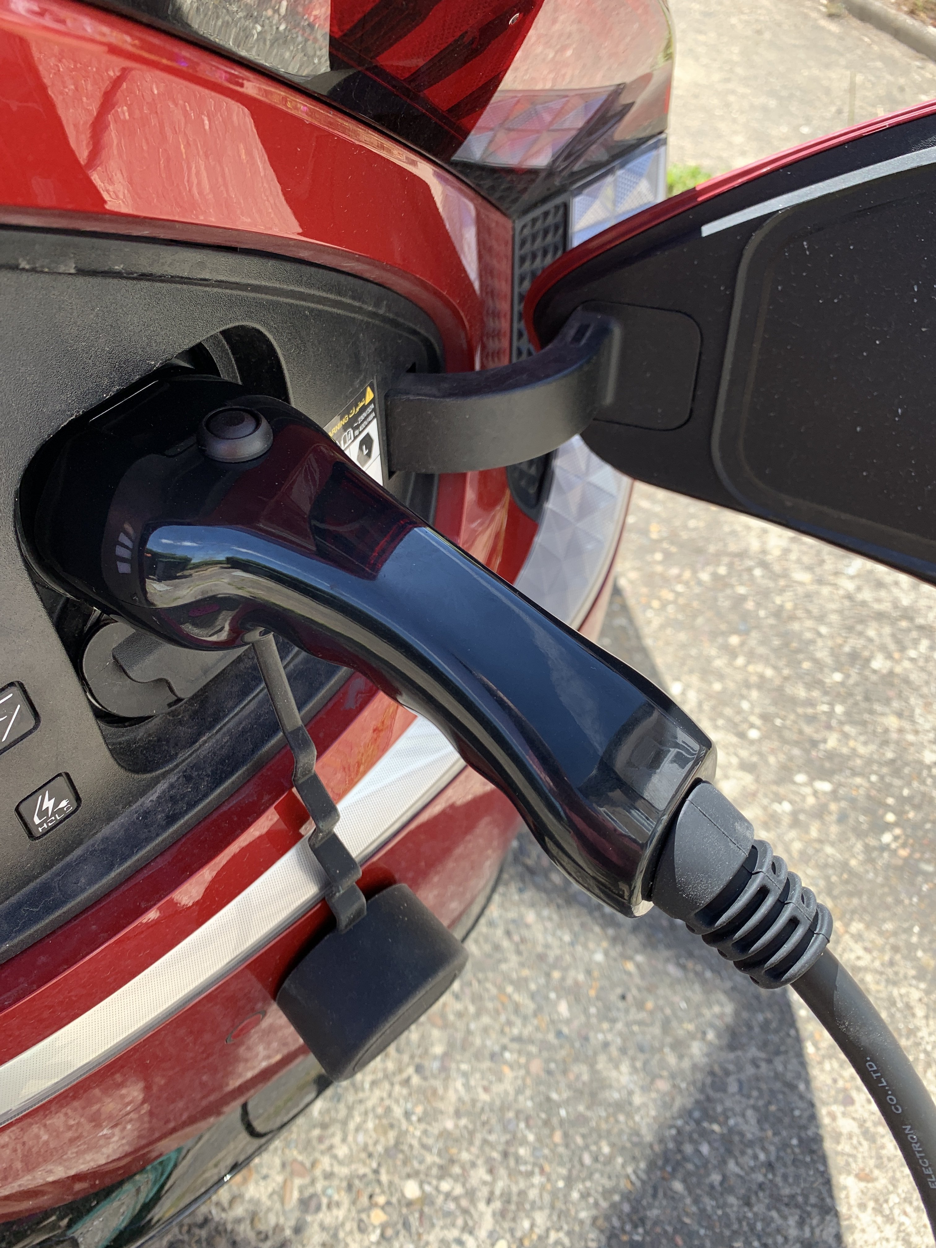

Just seen this on the Speakev forum. Any comments from our resident electricians eg @BugEyed .
The man who posts as Stageshoot on SpeakEV is a knowledgeable and sensible chap, as well as a good bloke in real life.
What he's doing complies with the regs and is basically as safe as running your house off of any generator and disconnected from the grid.
The key is the mains isolation and the local Earth.
