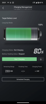

My app seems to have locked in long range mode without me being able to dial the planned SoC back to the health mode around 80 per cent. It probably doesn't matter that much, but I'd like to be able to choose my own set up as it should work.
Any ideas why it's locked and how to change it back?

This is the zs room but is it a LR or SR the option to reduce charge range is only available for LR models SR models should be charged to 100% so no option to reduce it
It's the SR. I have had the option to set the target battery level and it worked for about 15 days until it disappeared...
If it’s a Gen 2 ZS EV model standard range, then you do not have the ability to charge to any setting other than 100% SOC.
Although the App shows this facility, the car will not perform this function.
When you plug in a standard range model, regardless of its current SOC it will charge back up to 100 %.
The LR model is different, as you ARE a able to chose your required SOC from both the App and the info unit.
Both models have different HV battery chemistry and therefore MG have decided this is best charging policy for both each models.
