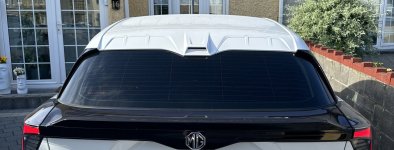

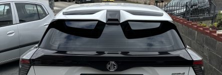

For those interested I've recently installed the trophy spoiler on my SE (essence and excite for Australia). Was a piece of cake. 9 bolts hot swap. For those wanting the se upper tailgate cover for their orange trophy I'm selling my d pillar trims and tailgate cover. Can arrange shipping.
