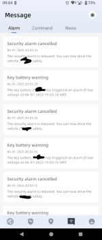

Your MG app should tell you what triggered the alarm, open it and check messages, see attached:
Yep, those are the messages I get and as we can see, there is no description of why they are produced. The alarm is cancelled and the security alarm is released.
