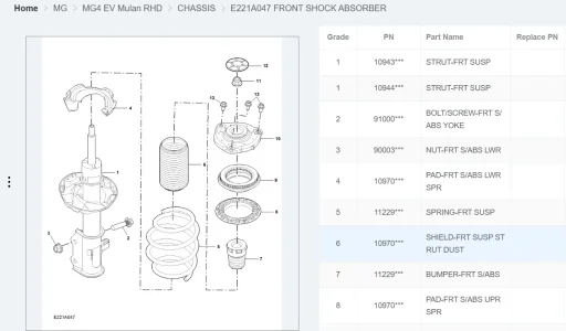

Apparently I need a new front shock absorber dust boot, my dealership tells me mg can't supply the dust boots separately and they have to order a shock absorber, this seems nuts to me, there are hundreds of different boot kits on the market, but searching online for one that fits the mg4 and I've drawn a blank, just wondering if anyone else out there has had this problem?
I've just found this in the parts catalog, the rubber dust cover does appear to be available, show this to your Dealer.
Just an update, my dealership was adamant that they can't get a dust boot, and wanted me to book it in for a new shock absorber, I declined and went elsewhere and tried the main dealer in Bury st Edmunds who can supply the elusive dust boot for £9 so I've ordered one, had to buy a few special tools, spring compressor and a pass through socket for the top nut on the shock absorber, will tackle it next week if the weather's ok. Oh and many thanks to @siteguru for the remove and refit manual for the mg4, without which I wouldn't be attempting the job. 🙏
