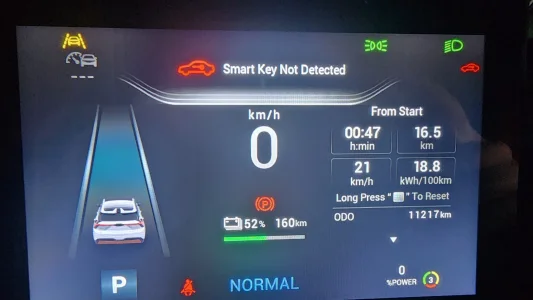

Hello.
As the title says, I get the "smart key not detected" warning. The warning only comes up when I stop driving and get out of the car. That is, after the trip is over. I can lock and unlock the car. However, the warning comes up every time I leave the car at the end of a trip. Same with the both keys.
Any ideas?
Thank you.

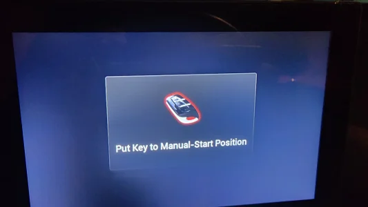

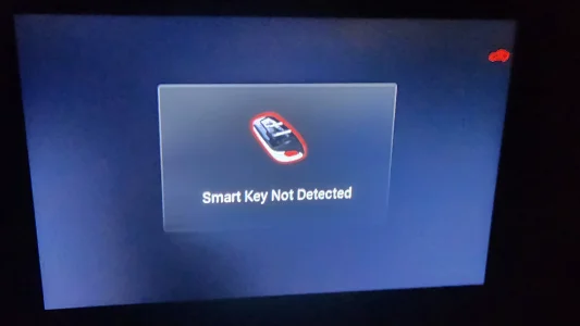

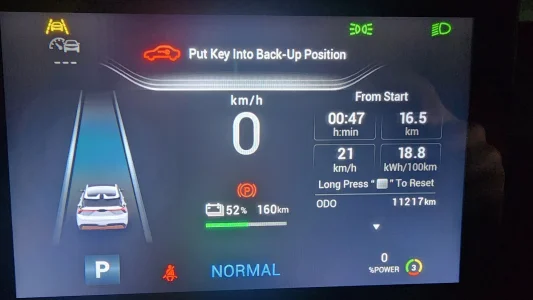

Hello guys I had the same problem, my car now at the dealership, they are trying to fix the problem, but here is how I managed to move the car:
Ps: we don't have access to the ismart app so it is out of the question.
  • unlock the car before sitting in it
  • after sitting, the car wouldn't turn on so to do so I lift my weight from the seat and unlock the car using the fob, sit down, it turns on.
  • press the brake the car would give you a warning and the it will not get ready to drive
  • unlock it once again using the fob to make it ready.
  • after driving a beep sound with warning will keep beeping for 5 minutes, afterwards it drives normally.
-here are the warning attached;

What happens when you put the key in the alternative start position (bottom of the centre arm rest storage box)
My car finally worked after installation of the body control module, it took my dealer more than 3 months to import it from China.
