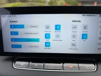

My HS PHEV was purchased towards the end of February 25 and I have been delighted with it over the last 12 months. I had it booked in for its first annual service at the end of February 26 and the garage informed me that there was a recall update for its Infotainment Screen. The firmware update that was applied was R67.
I am also delighted to report that the update also added 2 extra buttons on the screen when you swipe from right to left, showing ISA (Intelligent Speed Assist) which turns off the warnings if you exceed the speed limit by more than 1MPH, I am happy to leave that on.
The best one is DMS (Drivers Monitoring System) and after pressing that and a confirmation button, it turns off all of the bongs and dings etc when it can’t see your eyes properly. I wear glasses and it very regularly says that I need to pay attention to the road. I don’t object to the concept required for NCAP 6, but it is just far too sensitive and as I said, it can’t see your eyes when wearing glasses and sunglasses.

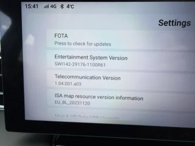

I purchased a HS PHEV 2025 (MY25 I think) - registered in March 2025, recently.
Although I asked for any software updates to be installed I discovered that it had R46 and the Custom buttons could not be programmed.
Took it to the dealer yesterday and it seems they installed the R61 update. The Custom buttons now work and, unless I had missed it before, the screen visible on swiping down now has a DMS button which turns off both the Driver Fatigue and the Driver Monitoring System. It has to be confirmed but is still quicker than going into the MG Pilot and switching off individually. Still has to be done each time the car is started though.
I will attempt to add photos.
