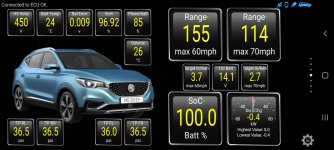

Morning all.
Just wanted to ask about battery SOH.
I picked up my car in April with 7100 miles on the clock and after using the Torque app to check everything I was happily running 100% SOH, 449 V and 163 miles after a charge and resetting the GOM.
Fast forward to today
10986 miles and just completed a full charge and balance.
I have been checking this regularly and have noticed the SOH is dropping quite a bit now since purchase.
I am still showing 449V after the charge but the GOM is now reading 158 miles after a reset.
The SOH in the torque app is also now 96.92%
This seems rather excessive in less than 4000 miles since purchase.
My charging regime is nothing excessive twice a week at home or work (7kw) and it always gets a balance.

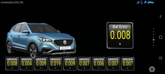

Checking my cells also shows bank 4 has the greatest inconsistency across its cells when compared to all the other 8.
I am concerned that at this rate I am dropping nearly 1% every 12-1300 miles.
Is this normal and acceptable ?
If the battery is guaranteed for 80k miles.
By the time I get there it will have lost around 60% of its charge capacity
Which would induce a warranty claim as they quote less than 70% for repair/replacement.
It may be just one of those it hasn't moved much initially for the first 8000 miles or so and now will even out.
What is everyone else's experience.
Thanks

I’ve never achieved more than 455v and 160 predicted miles since new. I understand that battery degradation is not linear. Most packs will take a hit during the first 12 Months depending on the number of times cycled. What this should be I’m not sure anyone really knows at the moment. I think there’s loads to compare against with members on here which is probably the best measure.

That does sound rather concerning to be honest with you.
A lot of people on here have higher milage that you but not lost any SOH (or certainly not as much as you).
When was the car registered?
We don't know how the SOH is calculated, but age could be a factor, could it be yours is one of the very first cars produced/oldest around?
I did find and post something on here before I found out about SOH degradation curve, it was not linear - higher to start with and then much less, so it could be that it will calm down a lot and not appear to be so bad.
Maybe it is that particular cell that you mention that has a slight problem, all you can do is keep an eye on it really.

This may be a silly question. If the fully charged voltage remains the same how can the state of health be reducing? 😝
It is a good thought, I had it myself when I first looked into SOH.
I don't think the battery capacity works like that though. It'll still have the same voltage range I believe but effectively the voltage will drop quicker as the capacity is less.
My understanding would be that state of charge is indeed the voltage and state of health the ability of the battery to deliver it’s full power.
Hmmmm. It’s an interesting topic. I think delivering full power and being able to maintain the capacity to deliver range are different. I think that packs that are obviously degraded can still deliver full power but their capacity to provide range is considerably reduced?
