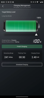

It also often finishes a full charge then drops to 1.8kw on the charger app and stays there until the charge slot is complete and the charger turns off power. I suspect this power draw is battery heating.
Reason for this assumption is that the load is too big for the balance cycle. On the ismart app on the SR it says heating off.
However I noticed on the LR as it did the same the other day drawing around 1.8kw on the charger, battery 100% but heating on.
Pics attached, the LR only did this when I charged to 100% for a long trip, it's normally charged to 80%.
SR in for first service soon, will be asking dealer.
Power for balance charging normal but I would like the option to change if it heats after or not as this is waste of electricity if I'm not using the car straight away.
