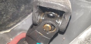

Hi all, so my steering started clunking when turning the steering wheel, I looked and found the universal joint had failed. I asked MG if this was covered by the warranty, they said if it was a manufacturing fault it would be, also I was within the 3 year window, I thought it was a 7 year warranty. I have had noises from the steering from about 5000 miles in, which was noted on the 1st service. Any thoughts on if it should be covered by the warranty?

If you look on the UJ yokes, you can clearly see the deep impressions made in the metal, as the yokes have been knocking together due to the excessive amount of play because one of the UJ cup bearings has broken up or fallen out of the UJ yoke.
Is there any of the UJ cup / bearings on the carpet etc ?..
