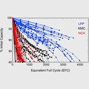

What is your information source that LFP batteries are better if charged to 80% most of the time?
Tests carried out on the LFP battery demonstrate that repeated cycling from 0% to 100% to 0% has very little detrimental effect on the battery.
The LFP battery is good for around 4000 charge cycles maintaining 80% of its charge capacity.
Even if you assume an average of 150 miles per charge cycle that will give you 600,000 miles of driving and still the battery will have 80% of its range capacity. Lots of other things on your car are going to wear out before the battery does.
However, if you think that not charging your battery to its full capacity is in some way going to help, then that is it your decision, though this is against accepted advice.
IMHO, just charge the car and drive it, don’t worry about the battery.
Note that Tesla also recommends charging their cars fitted with LFP batteries to 100% as often as possible.
Merely that it's well known that voltage, along with temperature, is one of the known killers of any battery chemistry. Voltage gives particles potential energy to overcome energy barriers, temperature gives them kinetic energy to do the same. The energy barriers are to well-known irreversible chemical reactions that reduce battery capacity.
Yes, but I read somewhere that Tesla LFP batteries (which are some of the earliest LFP EV batteries) have shown way more degradation than expected.
I can't quickly find that post, but see for example
that more or less supports my position.
I don't disagree that the difference in degradation (charging to 100% always versus to 80% mostly) is small. Just that since it's non-zero, if you have the lifestyle to support it, it may be worth doing.

Info source is here:
