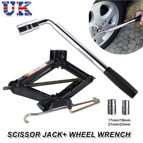

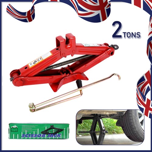

Looks like the same one but a lot cheaper
or even cheaper..
Aye. I saw that one and have it saved in my eBay watches. It's just that Amazon's return policy is great if it doesn't work with the car for any reason.
