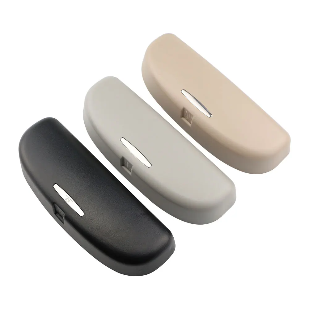

OK, Here we go...
This is what you need to buy, it's exactly the right size.
Buy the grey version as it matches the MG headlining.
I don't have any more pics of when I did this, but you'll get how to do it from the description and the finished pics, if you don't, then you shouldn't be doing this job anyway (no disrespect, but don't do this unless you're very OK with this sort of work on cars, risk of creasing the headlining, buggering up the airbag etc!)
Once you get the holder, you need to cut off the lugs at the rear of the mounting brackets (used for mounting on the original BMW fitment) so the rear of the mounts is just flush, then drill M6 holes in the centres like I have in the pics.
Using masking tape on the headlining, offer up and mark out the 2 hole positions.
By hand only, (I mean in your hand! do not use a drill!) with a 6mm drill bit, just turn it through the headlining carefully to open out the 2 holes, gently, it takes no effort at all, and through just enough to clear the headlining.
Pull down the seal between the frame and headlining to gain (limited, tight!) access.
Mount the holder using 12mm long, dome head, M6 bolts, with M6 x M40 penny washers and M6 nylock nuts to the rear of the headlining. This can all be done through the gap with the seal pulled down, by very gently easing down the side of the headlining, note, you will crease it if you pull it down more than a very little!!. You need to work by sliding your fingers up through the small gap, placing the washers over the bolt ends and starting the nuts whilst holding the holder bolts in place with the other hand on the inside. Then slide a 10mm open ended slim spanner to hold the nuts whilst running up the bolts with allen key until tight.
Done! carefully reseat the seal back in the gap and admire your holder.
Pics:
The holder is only mounted through the headlining material, hence the 40mm washers to spread the load, but works perfectly well for the glasses holder. Obviously, you can't use this method to fit an additional pull handle as it won't be load bearing!! ( just in case, there's always one...)
To reiterate, although a very simple job, it is very awkward to work through the gap behind the liner with it in still in place, only do this if you have the right type of dexterity, at your own risk and all that. Be careful not to damage or disturb the folded curtain airbag in any way as you're close to it. You could drop the lining to allow easy access, but that's prohibitively involved.
If you are mad enough to do this, enjoy... :)

Thank you so much Kazza, it helped, and I can confirm the grey match the trim colour perfectly. On mine I tapped M6 threads in the plastic covers and as of now it feels stable.
