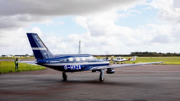

I hear your skepticism, but it is being pursued.
I'm glad it is but all of the evidence suggests it wont work, cant work for very good reasons. JCB are promoting their Hydrogen powered plant but it really has nowhere to go. Very frustrating really, as a fuel being burned it's great with only water as it's emission, it's just getting it, storing it and transporting thats the slight problem.
