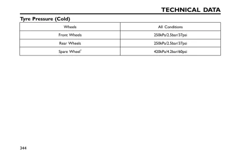

If it's not there where can I find the correct tyre pressure and on an MG3 Hybrid is there anywhere that shows the current tyre pressure reading
These are the tyre pressures, from page 344 of the Owners Manual.

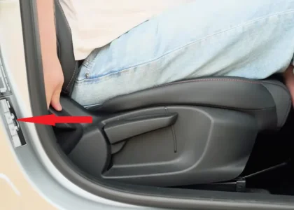

I've just checked my car on the driver's door pillar there are 2 stickers one large one with SAIC on showing the trim and paint codes and a smaller one marked MG showing the tyre pressures
I've been trying to find a picture to show the position of the label, and this is the only one I have been able to come up with.
