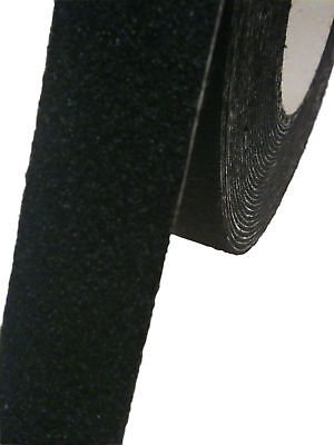

Or remove the wiper scuttle panel and install some silent tape to the back contact surface of the rubber / plastic gasket.
This cures the hard foul condition and the horrible clicking / creaking noise.

You really only need to release the wiper scuttle panel, in order to make installing / refitting the silent tape to the plastic gasket.
That's if you intend to go down this route.
It's a "top tip" though, if you only intend to clean and apply the lube to the gasket and refit (y) .
If the rubber gasket is the only part in touch with the glass wouldn’t you apply the tape to the rubber?
It's a "top tip" though, if you only intend to clean wouldnt you want to apply the tape to the rubber, not the plastic?

Not yet, gonna park in the sun tomorrow so things warm up a bit and take the scuttle off and either grease or use so anti-rattle tape.
