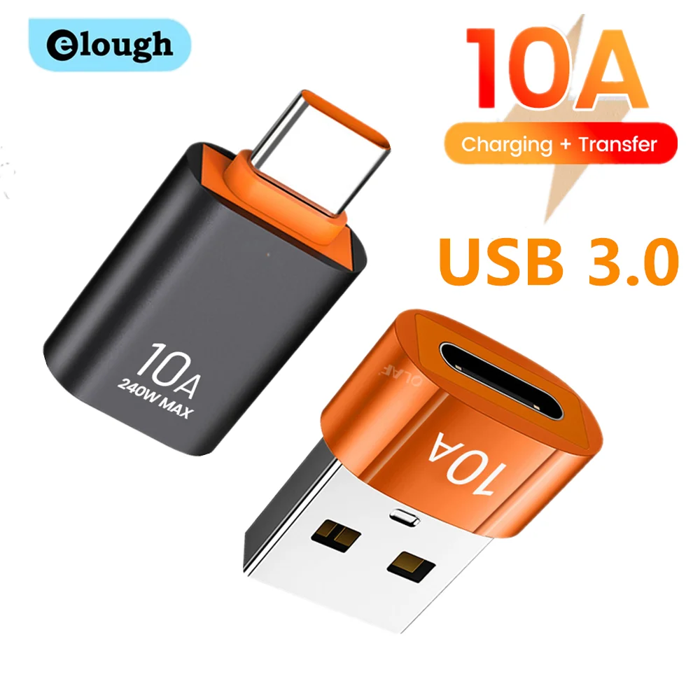

Edit: USBC to USB-A convertor also works ! I'll get link for it here

By the way, if you get a USBC-USBA converter, then use a USBA-USBC cable it works fine. Just not directly with a USBC-USBC cable. Just weird and I'm starting to hate this car.
