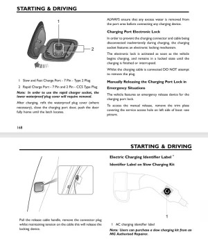

If it happens again, just use the manual release inside the boot. :)
My MG4 pulls that stunt every so often and I have to use the release cable, but a good spray with WD40 dry silicon fixed that and the charger door refusing to open ..... although, I pried the plastic lid off the first time the door wouldn't open and exposed the star shaped plastic fastener, a turn of that releases the door .....

By far the easiest way is to just give the release cable a tug, it's inside the boot directly behind the charge port. Behind a small square blanking thingy if you have not looked before.
