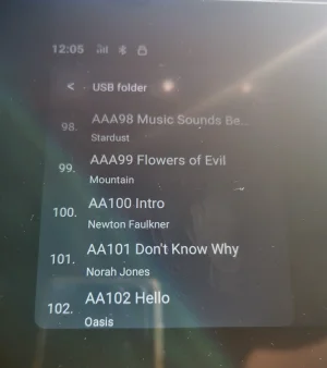

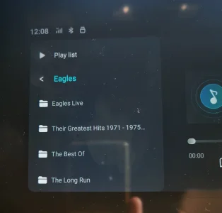

I hope this might be of help - I agree the system is woefully inadequate but, with much patience, I have finally managed to create a "workable" solution (although I shouldn't have to, MG should have produced a logical, user friendly, interface).
I have a 2025 HS Trophy PHEV.
Initially my usb drive contained 3066 music tracks, stored in the conventional Artist / Album / Tracks folder format.

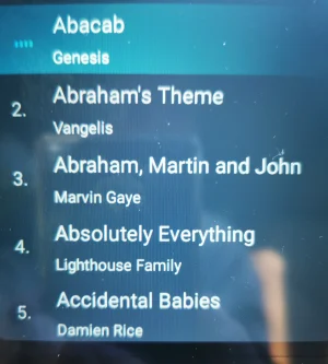

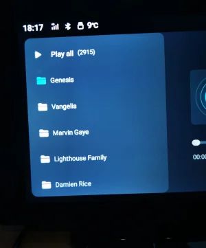

Whilst the car "read" all 3066 tracks (and could play them), it displayed the "No Tracks" message to the left hand side of the display. After much stubborn persistence I discovered 2930 seemed to be the maximum number of tracks my car would accept before it resorted to the "No Tracks" message - don't know why, just know it did.
So I now had a list of tracks sorted in alphabetical order which, in turn, dictated the sort order for my artists. In my case "Abacab" by Genesis was the first alphabetical track, so Genesis were top of my artists list.

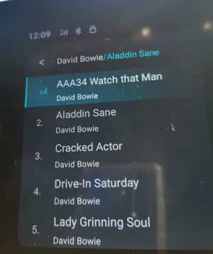

In order to restore my artists list to alphabetical order, I had to "fudge" the mp3 tags as follows:

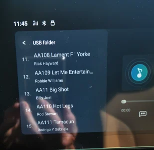

1) Prefix the "Title" tag for the first track in the "Artists" folder for each individual artist - make sure it is the "Title" tag, not the "Filename", the "Title" tag will normally be simply the track name.
2) Because the MG system reads numbers as characters ("AAD" is read before "AA1", and "AA109" is read before "AA11" for example), I had to use the following format for prefixes:
AAAA1 - AAAA9 for the first track for artists 1-9,
AAA10 - AAA99 for the first track for artists 10-99, and
AA100 - AA999 for the first track for subsequent artists.

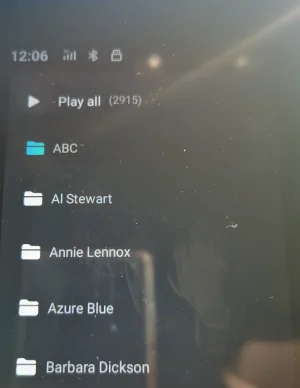

3) Finally I had a list of Artists in alphabetical order which, when selected, showed their respective albums and, in turn, their respective tracks, enabling me to find and listen to an individaul artist or album as I wished.
I used a Windows utility called Mp3tag to make the changes - available free online.
Finally, it doesn't actually matter which track in the artist folder you choose to prefix, I simply found it simpler and "cleaner" to use the first one.
The attached images should help to tell the story.
