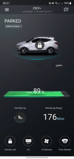

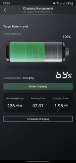

I've posted on the other thread on granny charging, but here is my second time, car was at 69% woke up this morning and unplugged it at 89% , so basically charging 20% or 40 miles in the 5 hours cheaper tariff with Octopus Energy.
As long as I can do this consistently this works for me, as my OH doesn't use it long trips. If we put it up tonight we can fully charge it. Wouldn't mind getting a charger in the wall, but how my car parks its about 20m from my CU. Not looking at paying a few thousand to install it right now, I'm sure it will change in winter time 😀
