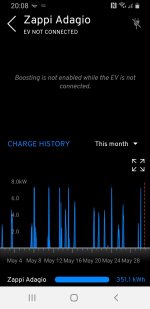

Yes I use a zappi in eco+ mode. From my 7.02 kwp pv system April was 882kwh, May so far 981kwh. 351kwh went into the mg5. You peeks at 7kw are boosting overnight on octopus agile. Every thing else is from the solar pv.

These are some impressive figures! Are you on or off grid? We've got 4.5kw and it seems we should get around 550kwh this month.

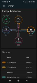

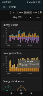

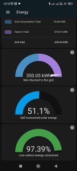

We have a 4kw array along with 7.8kw of battery storage which generated over 760kwh in May.House is about 1000ft above sea level, with a south facing roof and no shading at any time of day so the panels are really kicking out about as much they possibly could.
Our home EV charger is an old style pod point without any smart functionality so we generally leave the car on the granny charger plugged into a socket controlled by a Shelly device and linked to Home Assistant.
When the house battery is full (usually by 10am this time of year) the car is automatically trickle charged until such time as the house battery reaches 90% or we get to 30 minutes before sunset. We've done this for a while and our car is pretty much free to power for about 7 months of the year.

What is that screen shot from? I don't have anything like that on my Zappi app - I find the Zappi controls pretty inadequate and have to set an alarm on my phone to remind me to manually turn the zappi off before the house battery (8kwh) gets too low or it starts taking power from the grid (if in Eco mode,not Eco+)
For most of the year I find the 8kwH house battery is more than enough for the house demand (no electric heating/water) so in winter I charge the battery to 80%on Octopus Go cheap rate each night and then dump any leftover in the evening into the car. In winter if car gets too low for next days use I charge it on Go cheap, which will add 50% in the 4 hrs (MG5 SR) to the car.
In summer mostly all driving is on solar, either charged on Eco+ while the sun shines, or extracted from the battery (which isn't using Go cheap rate in summer,just the solar - 2.6kW notional but E-W facing)
No me also never seen that screen on my Zappi or its App
