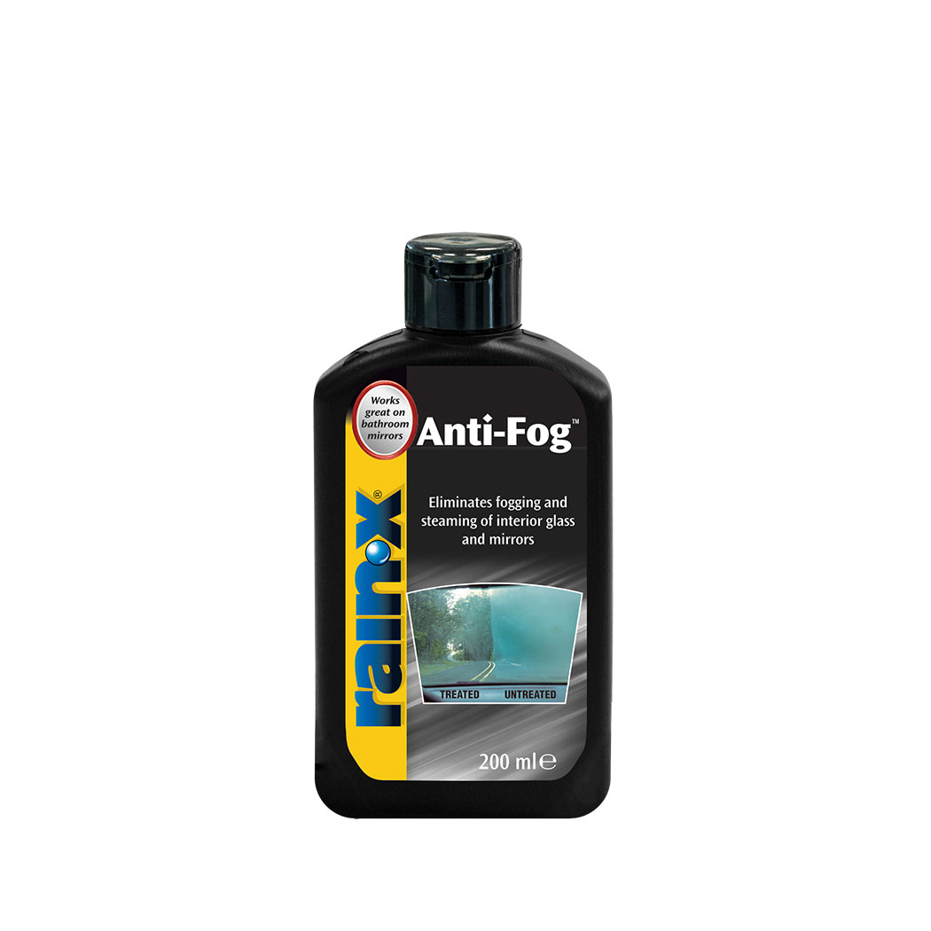

This works ... trust me :)
You will still need to put the AC / heater on a little bit at the worst of times but much less than before using this product.
Rain-x anti fog on the inside of the windscreen makes a huge difference. It can last several months before it needs reapplying.
Amen to that (y)
For me in my 71 plate pre FL, it’s a/c on, temp at 16 deg C and fan speed of 1 bar. This works for me. I’ve done various methods and find this is the best and I’ve not got the windows open on a damp cold day.
I applied Rain-X anti fog at the weekend, but haven't actually used the car since to judge the results. I haven't used any on the rear windscreen (though it's really needed there) as I couldn't find any mention on the bottle or the Rain-X website saying that it wouldn't damage the rear window heater element/aerial. Is everyone using it on the rear windscreen? It their rear demist and radio still working?
Just press the button for rear screen demist if needed like you would in any car. That of course activates the heated mirrors so will help there too. Simply using the AC on all the time and you can avoid spending money on products.
