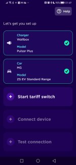

Finally, looks like my Wallbox Pulsar Plus is now compatible with Octopus Intelligent. Also looks like the rest of Wallbox products may also be compatible with OI.

Ah, this is potentially exciting - we have the same charger. Thanks for the heads up. Would be interested to hear if your test charge works successfully please

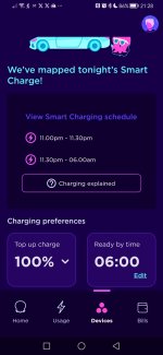

Test charge all done & successfully completed.
Smart scheduling active.
Happy days!

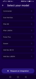

Not yet - I have been waiting for assistance from Octopus since Saturday. It’s very disappointing and frustrating that they haven’t responded. My Wallbox light is ‘amber’ but I did manage to charge the car anyway. However, I am being careful with mileage in case I can’t charge it again until everything is sorted.
These are the messages that have come up on the Octopus app
