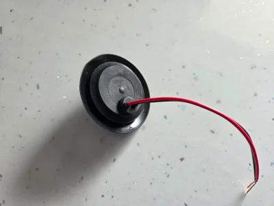

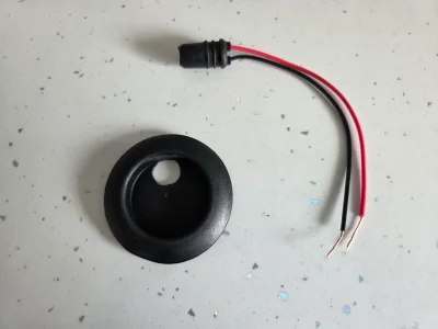

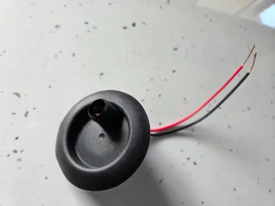

If anybody is interested, it's just a pre-wired rubber T10 / 501 bulb holder with a red 501 LED bulb, mounted into the access grommet, and wired into the high level brake light.

Looks good... though, if one was to be really nerdy... then, technically, front facing lights should only be white or yellow 🤓
The Road Vehicles Lighting Regulations 1989 No. 1796 PART II Regulation 11 said:
Colour of light shown by lamps and reflectors
11.—(1) No vehicle shall be fitted with a lamp which is capable of showing a red light to the front, except–
(a)a red and white chequered domed lamp, or a red and white segmented mast-mounted warning beacon, fitted to a fire service control vehicle and intended for use at the scene of an emergency;
(b)a side marker lamp or a side retro reflector;
(c)retro reflective material or a retro reflector designed primarily to reflect light to one or both sides of the vehicle and attached to or incorporated in any wheel or tyre of–
(i)a pedal cycle and any sidecar attached to it;
(ii)a solo motor bicycle or a motor bicycle combination; or
(iii)an invalid carriage; or
(d)a traffic sign.
