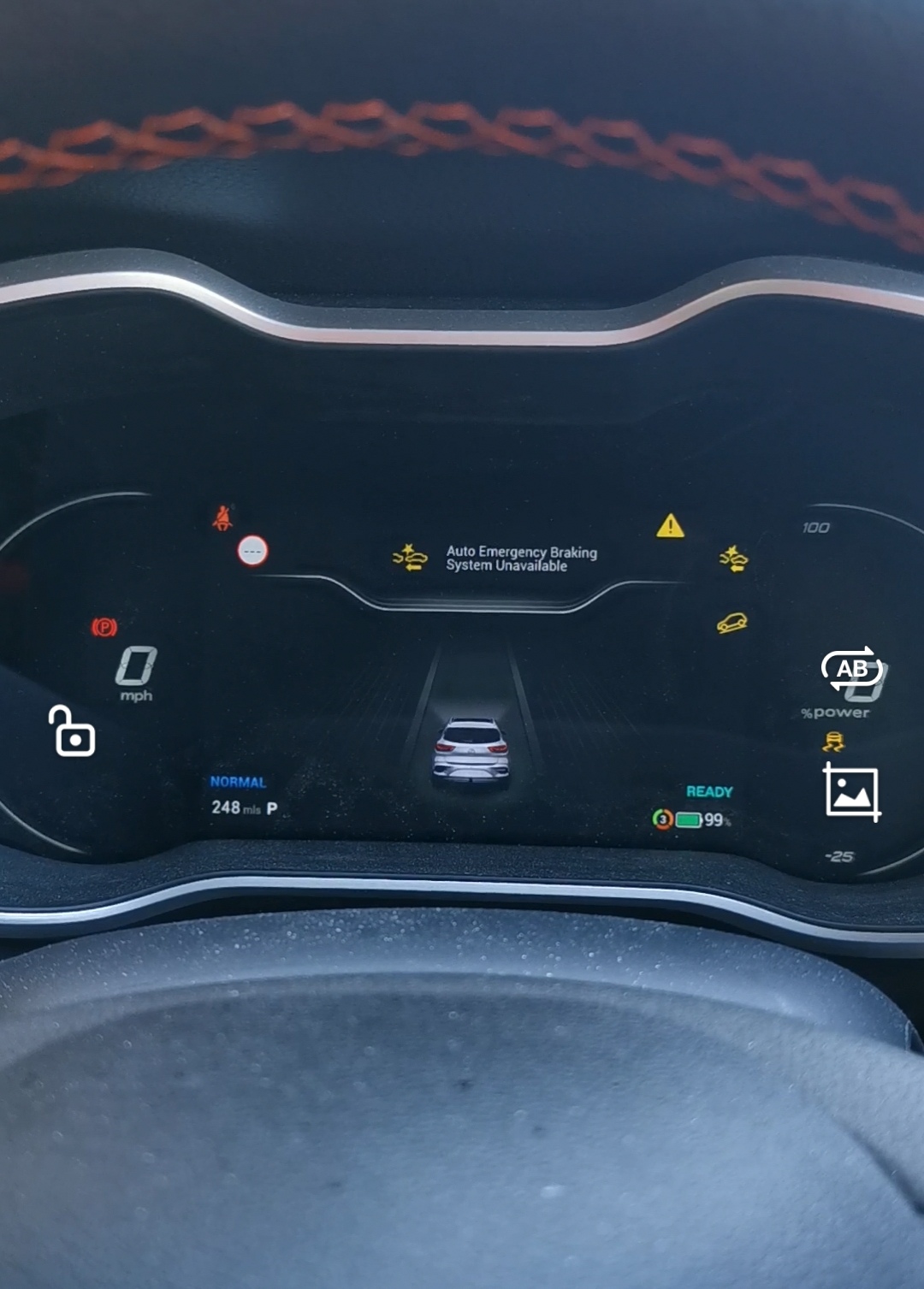

So this just happened, on holiday in Cotswolds and literally just set off on a journey and all these warning lights started coming up (see pics), car steering feels light and seems to be pulling to left. Anyone had any experience with this? Currently waiting on AA ?

Just turn the car off for 15 mins then restart. Should be okay.
As these messages are related to centre screen suggest you try power the car up and hold the bottom left button for 10 seconds to reboot the screen.
If this does not work then try holding the start button for 30 seconds.
The important thing when powering up the car is to let everything get to a good condition before selecting Drive or Reverse.
Just to say that I have had this a couple of times where I have “rushed” the car during the start up process and driven the car with no problem. The “safety” features will not be enabled, but the car will still drive. After parking the car up and returning to it, all was fine.
I totally agree with Michael, have you rushed the boot up process of the car ?.
Another idea, have you had any of the 12 volt items running with the car still in the "STANDBY" condition and not the full READY condition ?.
Why - Because numerous fails can be thrown up IF the 12 volt battery status is too low.
What is the current 12 volt battery voltage condition showing, on either he dash panel or in the App on your phone ?.
I would shut down the car and lock it, walk away for about 30 mins, then try to boot up the car without rushing through the process again.
Keep your foot hard on the footbrake until you hear the "READY" bong and only then use the gear selector switch.
If you rush it, the car will complain, trust me !.
If it boots up just fine with no warnings, you are good to go !.
Check your 12 volt battery condition, the AA man is very likely to do the same with volt meter.
If the warnings are still there and your 12 volt battery is shown around 13 volts, you could try the old 12 volt battery disconnect, leave 15 mins and then reconnect.
He may scan / diag for fault codes, but I don't think it that involved to be honest.
Good luck.
That looks to be about the same error messages i get, when i do a reboot of the radio, while i am driving, when it does annoying things that needs a reboot.
Update, AA man had a look, couldn't get his diagnostics to talk to it as it's too new. After test driving he agreed that car was pulling to left. Once I mentioned about people on forum having disconnected the 12v battery, he tried that, now sorted. Don't have a clue what caused it, but hey, it's working now
