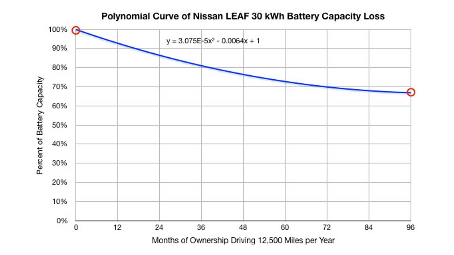

ok - lets follow that up with a question for anyone that's more battery minded. I (like most people) look at that and think (does that mean I can lose 29% of my range and have no comeback on warranty, but should we be thinking of this as more binary than linear (i.e. it's either a good battery or a duff one?) (Yeah, I realise there's lots of cells and it's not as simple as that, but bear with me)

Nissan have a graph based on age / mileage for range loss. If you fall below the line, they act, if you are above the don't.
MG state 70% after 7 years, so will have a similar graph.
I know you don't know how it works, but I wonder if for someone only doing 6250 miles a year the final %age will be 85% or thereabouts.
I expect a cleverer person than me can work out what that equation means... :)
That graph is for the LEAF which is the worst battery in existence due to its lack of battery coolant.
All others are better!

Interesting it seems to indicate that it levels off as time progresses. I expected it to continue to fall, as the car ages, ultimately becoming unusable. It would imply that once you get to about 8 years, if you're happy with that capacity,(which is probably good enough for a lot of uses), you can use it for as long as the car lasts ?
Is this a wildly simplistic assessment ?
What has happened with early super high mileage cars is that the LEAF follows that curve then seems to have a battery cell failure c 250,000 miles and owners tend to replace the battery with a larger capacity one. Ex Norway battery packs from crashed LEAFs abound at reasonable prices.
Tesla batteries seem to have a cell failure around 450,000+ miles that requires a unit to be replaced or a new battery. That is a good guide for an MG that's been looked after, much less of course with daily 100% charging.
In all cases the minimum work required is to replace a failed cell block & rebalance the battery maintaining the capacity lost. 4-8 hours work & a second hand cell pack.
