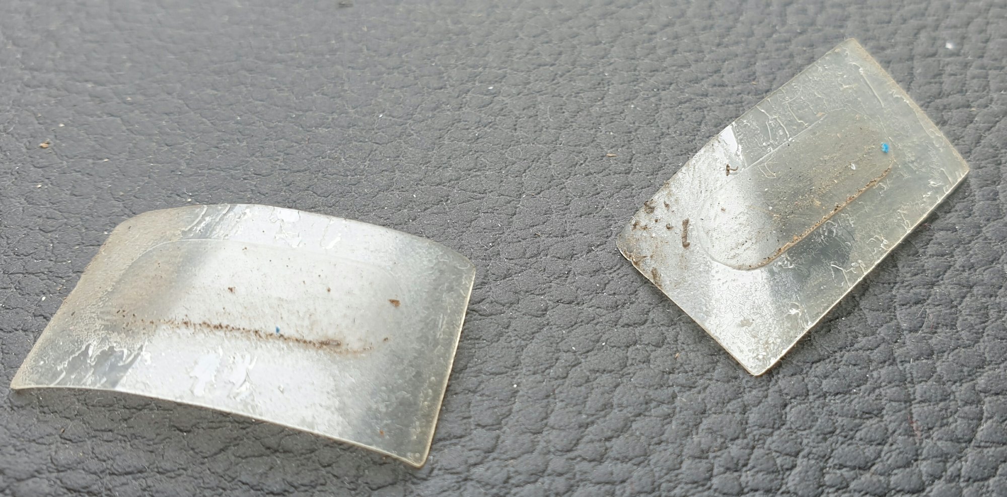

There's been a discussion elsewhere about one of the two door seals on the front doors being closed up with thick tape.
I just remembered to check and both of my front doors had two drain holes, the front ones were taped over, I removed them.
There was no trapped water.
There was no trapped water.View attachment 3989
Now your sills will get dirtier. ;)
