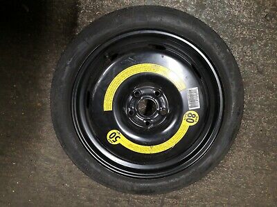

I previously had the ZS 1.0T Auto, which had the spare wheel kit (which I kept). Can I use it on my new ZS ? I would try it but ....

I really don't think the petrol wheel will fit
No it will not.
The ZS EV has the wheel hubs from the previous HS fossil.
The stud spacing / off set is different on the fossil ZS to the EV.
When the ZS EV Gen1 was first released, they sold the space saver from the fossil version to suit the EV model.
One owner soon discovered he could not get the wheel to fit the hub, when he suffered a puncher.
It was quickly flagged up to MG and they with drawn the kit from sale, a little latter they offered the space saver from the HS.
At first, the price of this kit was about £130.00 complete ( New / Old stock I suspect ).
The last time I looked, the kit had jumped up to about £250.00 !.
But I think MG have stopped selling accessories now ?.
@JammyJules there is just a spare wheel for sale on Ebay.
You have the jack etc already ?.
