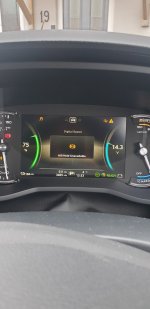

Oops
If only it was that simple, its spotless.

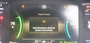

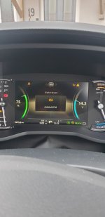

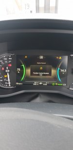

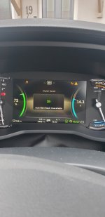

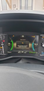

And its scrolls through these

It had the keys update thus week. I've just done the hard reset with the earth lead on the battery and the faults remained
I decided to go to the dealer stopped the car up the road and restarted as normal and all the faults have cleared
Think I'll pop it in in the morning
I had something very similar to this about 3 weeks after picking up my HS PHEV. Pretty much every warning light it's got came on whilst I was queueing at Customs in Portsmouth having just got off the ferry. Not long after that, the car died from lack of 12v power. It turned out the 12v lead from the fuse box to the battery wasn't properly connected - the terminal was cross threaded. As well as the battery not being adequately charged (which is what I think set off all the warnings) there had been a lot of sparking and arcing that had melted the plastic bit of the 200amp fuse. New fuse box and fuse fitted by dealer.
Hopefully it's not that but check the state of the 12v battery.
