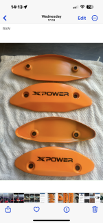

Hi Simon
Removing your calipre covers is easy (15 mins) the rear ones simply undo the two bolts & wiggle them out between the spokes. Front ones simply pop the wheel off then remove the 2 bolts. IF you pay them to remove them make sure they are with the car because you cannot buy them. Im disabled & removed mine last friday to have them wrapped a nicer colour. As for vibration my Dec 23 x power doesn’t have it. Enjoy the car & welcome to the group 👍
