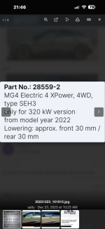

Very much Doubt you'll ever get Aero covers to fit the alloy wheels. If you really don't like the Orange caliper covers take them off or paint them. H&R lowering springs are now available for the X Power. 🙂👍
Ill probably wait on coils as i can adjust over time to where it handles best, but good to know those are avail

Chris, I’m currently in conversation with Eibach UK, reference the MG4 as they are contemplating a Pro Kit for the chassis, which will not only give you better handling, but also a subtle lowering to enhance the looks of the car.
From past experience, H&R springs can be very hard and in turn you lose comfort from the ride quality, however Eibach do make all the springs with a progressive nature, meaning you don’t lose any comfort but added handling.
I would highly recommend Eibach, so if you could leave it with me for a couple of days, I will see if Eibach would like to go ahead. If not, we can supply the H&R etc.
