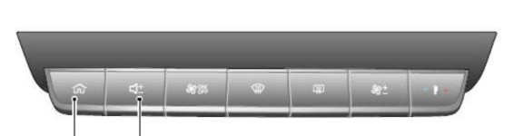

Although the fan speed button, (third from the left), is highlighted ON/OFF, has anyone been able to turn the fan off using this button pleased?
The lowest I can get it is to ‘1’. As soon as the button is touched the AC also comes on, which then requires screen navigation while driving to turn it off ! Thanks.

3rd from left. Short press takes you into the HVAC menu, long press turns on/off, if it was off it goes to the previous setting before you turned it off, great when I have it set up for demist most of the time.
Fan speed button is second from right.
